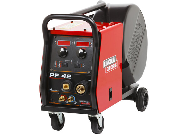

Advanced process Power Feed® wire feeder for use with Lincoln Electric digital power sources.
Output
Output
Input
Input
Advanced process Power Feed® wire feeder for use with Lincoln Electric digital power sources. Small, rugged and easy to handle feeders with bright digital meters. Utilises ArcLink® – the leading digital communication protocol for welding, making it the best choice for seamless, time critical integration with the power source. Four roll drive system with powerful motor. Hot/Soft start Crater Run and all standard features. Easy-to-understand user interface panels make it easy to set weld parameters. Equipped with wheels as standard.
Feature.Products.PDP.DetailsMain.Features
  • Small, rugged and easy to handle feeder with bright digital meters.
  • Four roll drive system with powerful motor.
  • Easy to set-up user interface equipped with bright digital meters.
  • 8 programs with quick access: 4 fixed as a welding process (GMAW, FCAW-GS, SMAW, GTAW) plus 4 which can be changed and assigned to one of four user memory.
  • All Power Feed 4X series can be optionally equipped with gas flow-meter, heavy duty undercarriage or lifting eye.
  • Equipped with wheels as standard.
  • Can be optionally equipped with gas flow-meter.
